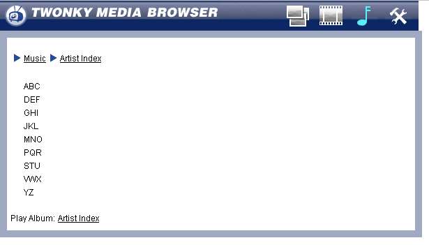

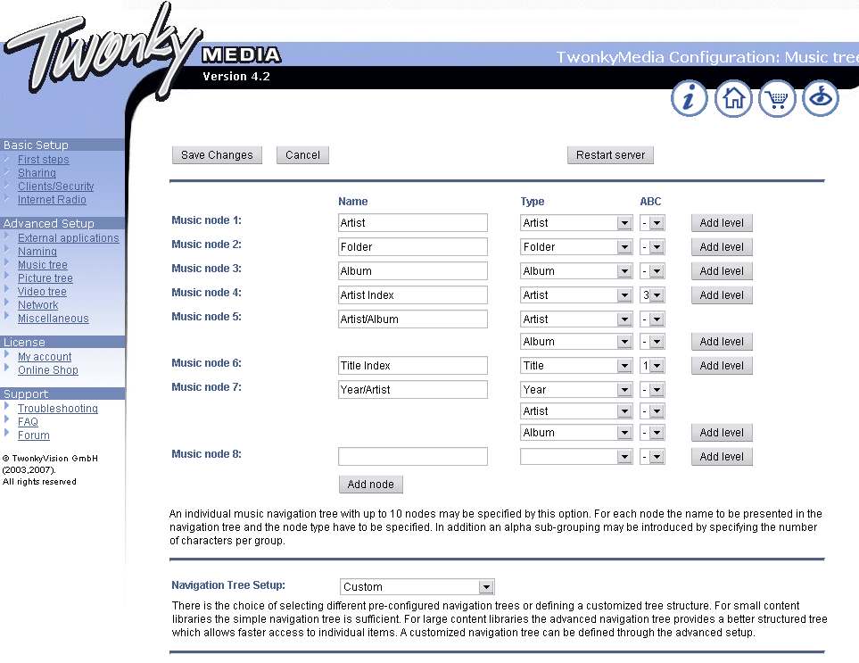

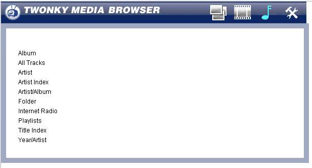

    What I like about twonky is the "tree" that can be defined to group the music files (including creating groups by 1-2-3 digits). See attached screenshots. It has even 2 automatic playlists: "last played" and "most played".
