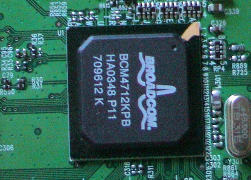

    This is even more then I was hoping for since I didn't even realize that a pull-up resistor has to be placed on the board in order to enable USB functionality. It seems that on Belkin it is R725. Can you confirm that these two lines that connect to pins B6 and C9 (thou I might be off a pin or two) are indeed USB lines? (Everything so far points to they are, but I thought I'd double check).
    As for the second USB port, it would be nice to pull out this one as well, but that would be another project. I see some unpolulated pads on the board around the CPU, these are for resistors: R34, R37, R653, R654, R655, R659 - but it is hard to say where they connected to it.
    Thanks again,
    Sergiy
    just thought I'd add some more info: the R725 seemed to be wired to the B8, and right next to it is a pull-down R889, which is connected to B7 - I wonder if this one has anything to do with USB?

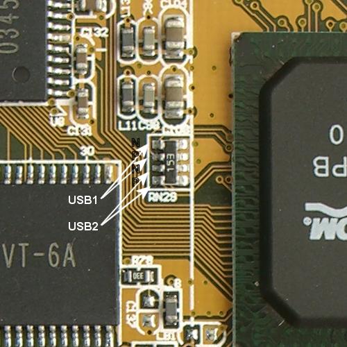

    I _guess_ that the second port can be used, but I'm not quite sure if the method works. (Haven't had time to try it.)
    On my rev. 2.4 wl-500g there is a 15k resistor package (RN28) which seems to provide the necessary pull down to GND for the two USB Ports (each one has two differential signals - USB_N and USB_P, of course). Maybe it's enough to connect an USB socket to the two solder points (and +5V & GND of course).
    Note: USB1 means USB - Port1 and USB2 means USB - Port 2.

    Just an amandment to gwl's post: In my opinion there is no clock generator needed/involved in any way; this seems to be a misinterpretation. Pull downs should be already provided via RN28.
    Most probably ASUS didn't implement any kind of filtering for the USB-port on the back of our router, so why should we bother to do this for the second one?
    A 15 Ohm series resistance is implemented via RN2 on my board, there are even two unused resistors available.
