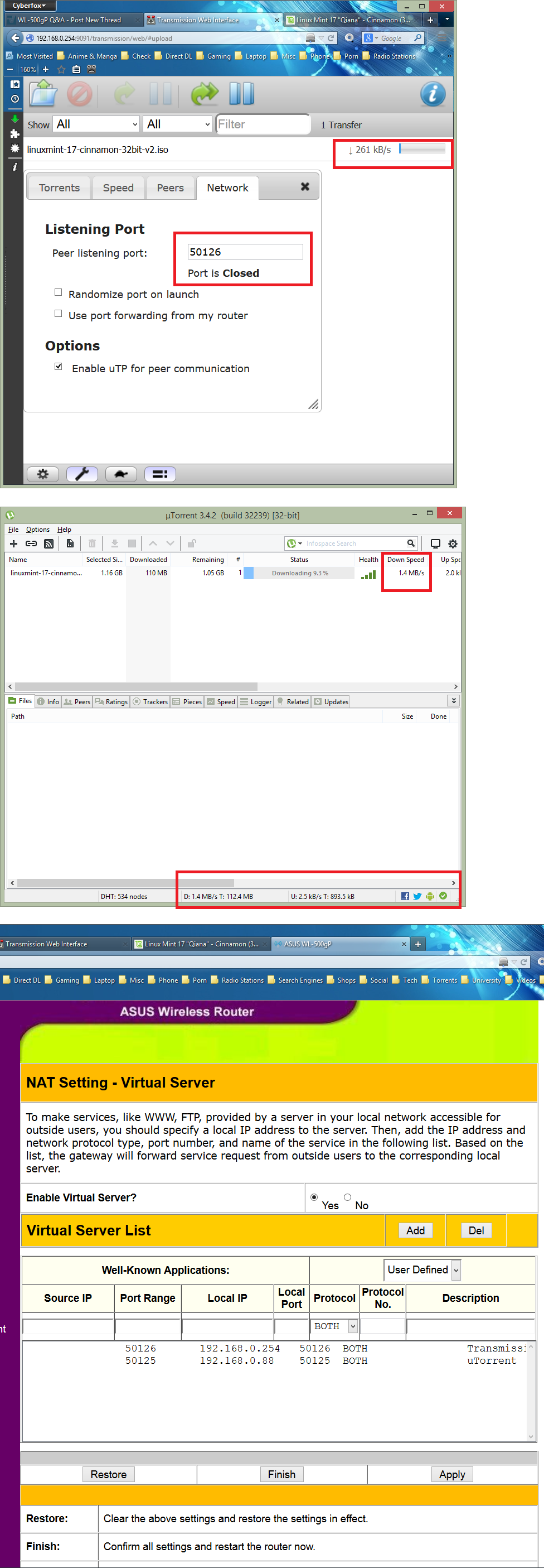

    So I have everything up and running finally on my old WL-500gP router.
    However, I have a problem I get slow speeds with Transmission up to 800KB/s, normally I can get up to 1.5MB/s with the same good seeded torrents from my PC and Transmission also reports that the port is closed.
    I'm going to attach the settings of what I have done so far.
    Thanks in advance.

    Firewallrule
    iptables -t nat -A PREROUTING -p tcp --dport PUBLICPORT -j DNAT --to TARGETIP:PORT
