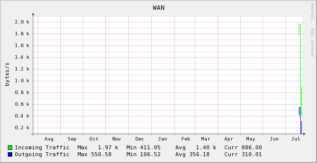

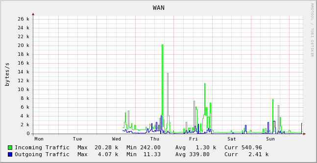

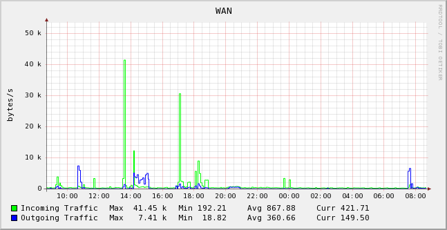

    Updates and screenshots.
    Hi
    There is a few updates:
    # The new graphs are bigger
    # Added Min, Max, Average, Current
    # During the image generation the graph are not accessibles so new images are created with a extention .new and renamed when done.
    Also some pics.
    Note that theese are the WAN pics, the script creates for WAN, LAN and WLAN separately, and also creates simple webpages that includes them.
    The script is not that old, and hence there is not so much history included in the graphs :-)
    macsat
    http://www.macsat.com - Tutorials and information on using ASUS WL-500G and family.
