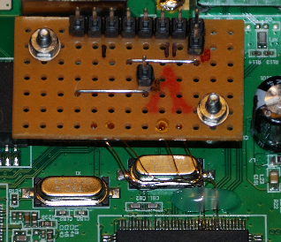

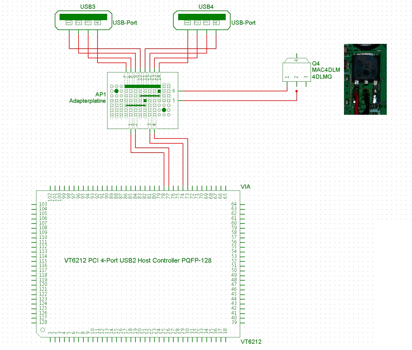

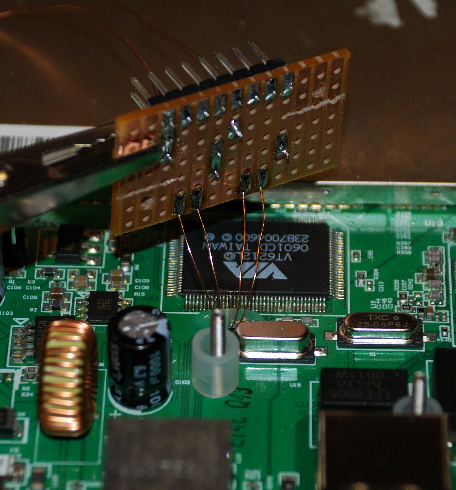

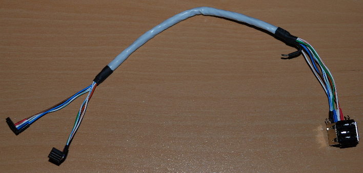

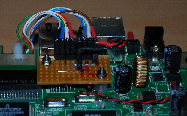

    Hello,
    I made on the german forum an tutorial to use the 2 internal USB ports of the WL500gP.
    Here is the google translation of the HowTo:
    http://translate.google.com/translat...hl=en&ie=UTF-8
    Thats the original thread link:
    http://wl500g.info/showthread.php?t=16005
    Good luck with that!

    Increase the required space around the WL500gP.
    You don't need an extra power supply!
    A stick, there is in use every day, isn't visible (ok, thats my personal feeling).
    You can also add extra internal components (there are not visible) for example: an "internal" usb sound module...
    The upgrade is a "nice to have" thing. But I think a lot of peoples would do that, but havn't an idea how. Thats the reason why I wrote it here.

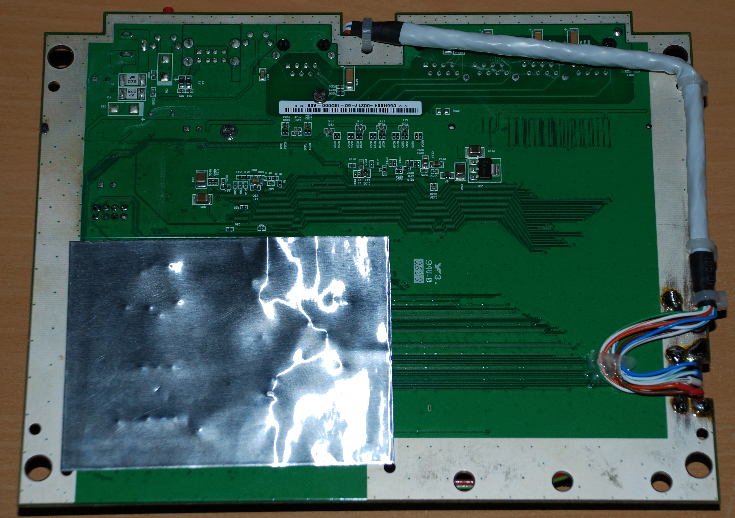

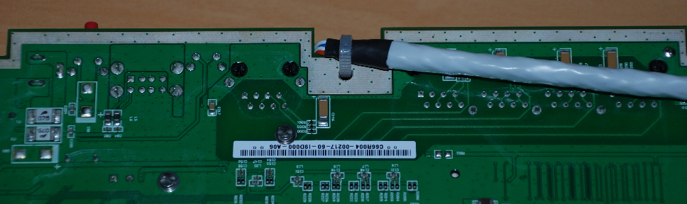

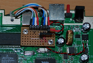

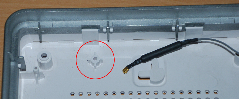

    Does anyone have this page archived? The images are not available anymore...
    Quote Originally Posted by purdeaandrei View Post
    Here are my archived pics...
    I must upload in more then one post. I can only add 5 files per post...
    more pics...
    also more pics
    again more pics
    Thumbs up
    the last pics and my original german post...
    Ciao
