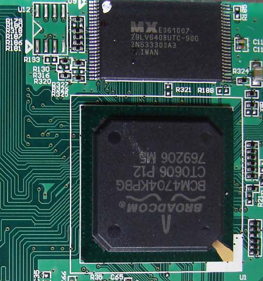

Components:
After a week long search some NANYA NT5DS32M16BS-5T were located. So why not give it a try? There was no confirmation for these back then, though according to the datasheet they were pin compatible and organised as 32x16. But when I was about to acquire them, I got a call from a second-hand store, about some SO-DIMM with Samsung K4H511638C-UCB3 gathering dust on their shelves, so that was it! These were confirmed by trucki and way cheaper too.
(Thanks to particleman we now have a confirmation for NANYA NT5DS32M16BS-5T)
33 Ohm smd 0402 resistors were kindly donated from an old dvd player, (one for A12 line, one more to replace an accidentally desoldered and lost one)
Method:
- Used a hot-air gun (the paint-stripping gender) to preheat the pcb and then desolder the (fluxed) memory chips, while protecting the rest of the pcb with multiple layers of aluminium foil as a heat screen, both from the SO-DIMM and the wl500gP.
- Applied no-clean flux on the pads, then removed the solder from the pcb pads with desoldering braid (wick).
- Cleaned around with some alcohol and some cotton buds.
- Positioned the chip, then kept it in place with some scotch tape (it *really* helps).
- Used a fine tip, low wattage soldering iron with tiny amounts of solder applied on the tip.
- soldered pins under optical aid.
- cleaned around some more.
- Scanned and hi-res macro-photographed the result from various angles to visually inspect on screen.
- checked for sort / open circuits with a multi-meter.
- reworked a few stubborn pins.
And voila! It didn't workno power led on
disappointment
At the time it was already very late at night, so I slept over it, many nights, and when I found the time, armed with multimeters, optical aids, pencil and paper for an improvised schematic, datasheets, previous pic's of the tracks under the chips and quite some patience I checked again every single track and pin on the first chip (U3). Pins 18 (Vdd) and 4 (DQ1) were found to be loose, giving false positives when pressed on their pads with the multi-meter probe. They were resoldered while I pressed down on them with a pointed tool and voila, router finally up and running!U4 was not much of an issue and soon I had all 128M of ram activated!
At first strong vibration would freeze the router (more loose pins) but then the soldering iron came again in to play, and everything worked just fine!
The router went through twelve runs of memtest and all is fine! Router is happy, I am happy, big Thanks Oleg!

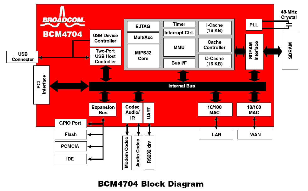

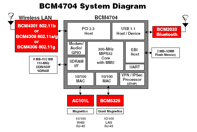

Most of my inspiration came by looking at these pieces of information: (attached below)Originally Posted by Oyabun
What kind of hard hacking are you thinking about?
* BCM4704 Block Diagram
* BCM4704 System Diagram
Well besides the gpio pins, I2C bus, SPI bus, SD card, etc type hacks, (directly off wl500gp pcb tracks), the most promising thing, may be the ability of BCM4704 processor to handle three mini-PCI 2.3 peripherals.
Another way to explore would be the EBI (Expansion Bus Interface) route. Signals for this bus are presented to the flash memory chip (SPANSION S29GL064M), of course stealing them from the chip's pads seems extremely hard, but it might still be an option for just a couple of lines. And since extremely hard is still possibleFrom Broadcom's BCM4704 Product Brief:
The PCI 2.3 host interface allows enumeration of three external PCI peripherals (more with external arbiter), one could even try an IDE connection if all necessary signals are found to be present and the firmware side of things in understood as well (that already sounds pretty complex to me).
Other interesting things are the modem and audio codec’s as well as the two-port USB 1.1 host. Interesting these are, however, only if their respective signal/data lines are present somewhere on the pcb, since un-burying them from under the BGAseems highly unlikely, to stay optimistic.
Software-wise, access to the MAC (Multiply Accumulate) unit on-chip would be very useful to people who wish to hook up some sensors on the wl500gp and then use it to perform some DSP (digital signal processing) on the collected data.
Also software-wise, access to the IPSec Core and related hard-wired functions available in the BCM4704 (IPSec 3DES, SSL MAC, TLS HMAC, SSL/TLS DES/3DES, MD5/SHA-1 HASH, IPSec AES), would be very useful for some types of network applications.
All of the above require, inside knowledge of the processor core, usually found in a Programmer's Guide type document and in datasheets, for the software part, whereas for the hardware part, processor datasheets and router schematics would be needed. Without any of these documents in sight, it's gonna be pretty hard to attempt most of these modifications.

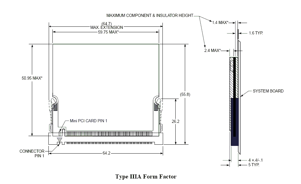

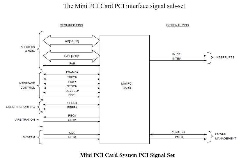

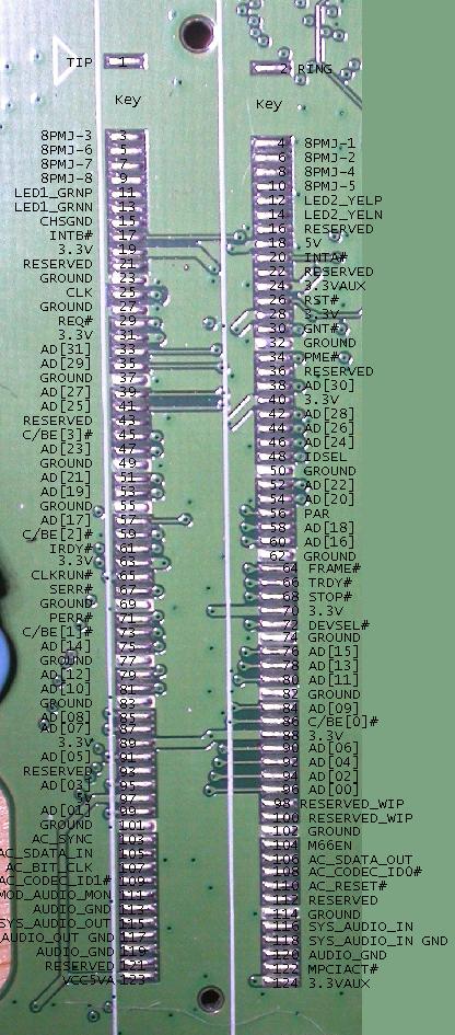

That's why I believe mini-PCI peripheral expansion is the most viable approach, given the available documentation.
PCI's, let's sum it up, we have: One for the PCI-to-USB bridge (VIA VT6212L), one more for the actual mini-PCI connector harbouring the wi-fi card, that's two, leaving room for (hopefully) one more! Plus all the signals for the PCI bus should be presented to the mini-PCI connector. That's only a guess however, I haven't actually checked to verify that, but still. The specifications for PCI and mini-PCI bus are at hand, so it will be a matter of (spare) time to verify it.
After verifying that all necessary signals are present and that the firmware (as is or modified) could handle such an addition, it might be possible to try and solder one more mini-PCI card connector on the existing pcb pads.
Many mini-PCI cards are available which could be used to offer additional functionality, provided the suitable driver exists, that is.

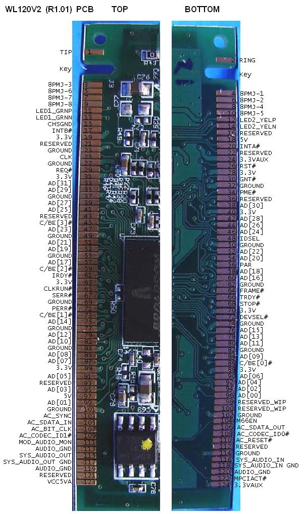

Below are some very inspiring BCM4704 Diagrams from Broadcom's Product Brief, a picture of wl500gP's case following modification to house the extra two USB connectors, and a couple of pictures of the actual post mod pcb.

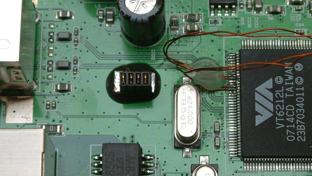

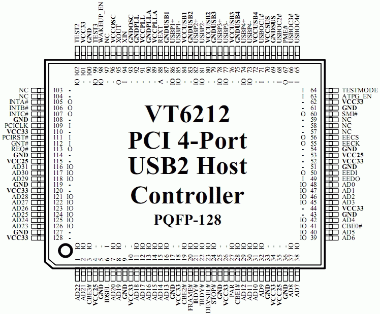

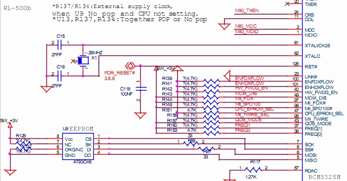

EEPROM interface
1. VT6212L (usb) have eeprom interface:
- EECS (O) - pin56
- EECK (O) - pin55
- EEDI (O) - pin50
- EEDO (I) - pin49
VT6212 specification does not mention about register to control this interface - maybe someone have any drivers that can do this?
.................................................. .............|USB1|USB2|USB3|USB4|1+--2 _3 4
2. BCM5325 (ethernet) eeprom interface:
- SCK - pin7
- SS# - pin8
- MOSI - pin6
- MISO - pin5
Interesting could be to access this interface via MII interface (used by processor to configure switch). Need detailed registers description to do it.
...........................................{EEPROM}.........V
FCC Dochttp://pudeev.livejournal.com/26318....195278#t195278

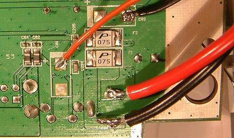

I also checked the re-settable poly-fuses (on the mainboard) used to protect the router from USB overcurrent and they are rated 0.750 mA. I checked their specs from their manufacturer and it turns out they trip at 1.5 Amps(!), not that i would recommend connecting anything that heavy though.
So as thing are connected now on the modded router, three usb devices are supplied from the power initially intended for one of the two original usb ports while the other get's all the current by itself.

Attached: 1) The measurements set up. 2) Cable connections (little cables usb mod supply, larger cables router supply)

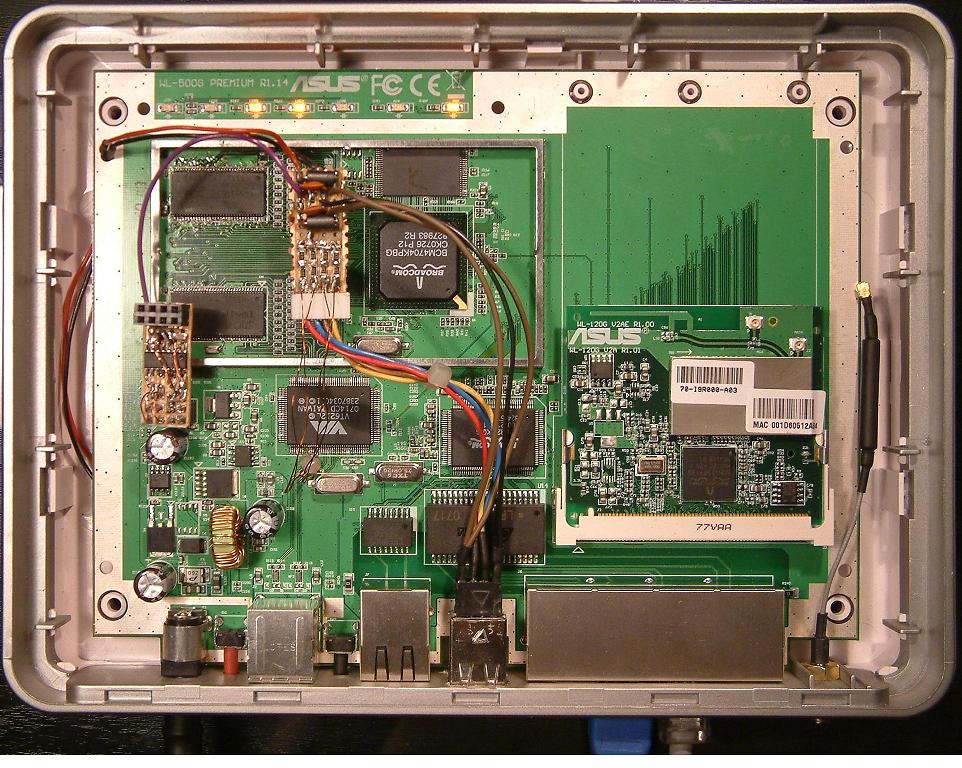

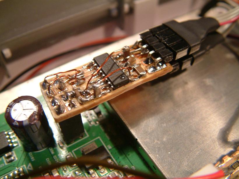

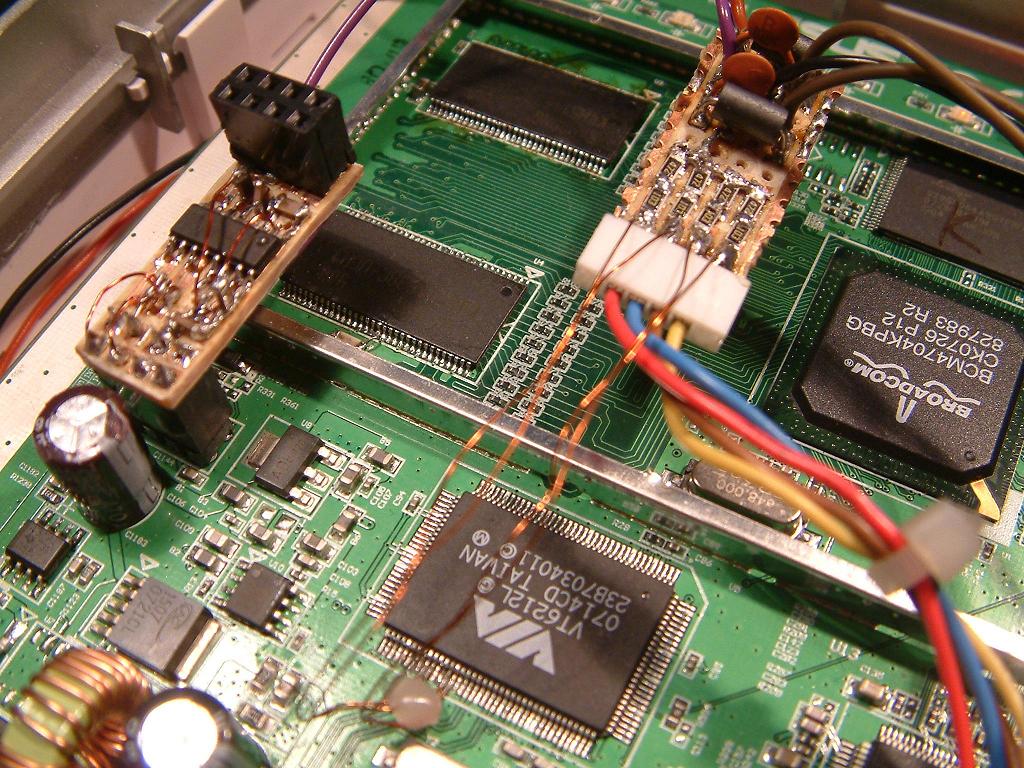

Following some posts in the forum on the RS232 port subject, a dual RS232 line transceiver was implemented, based on a 5-Volt, max202, narrow-SOIC 16pin chip. Spec's say that anything below 0.8 Volts is perceived as Low-Level signal whereas anything above 2 volts is perceived as High-Level signal so the 3.3 volts from the board are definitively interpreted correctly as a High-Level. Supply-voltage-wise the requirements range between 4.5 to 5.5 volts, so the on-board regulated USB supply kindly donates the appropriate voltage (and a maximum current of 15mA), keeping everyone happy. MAX202 is oriented towards battery operated, handheld applications, and only needs five 100nF capacitors to operate. Using smd ceramic capacitors results in a very small sized pcb. The transceiver circuit was tested OK using a USB to RS-232 converter and a plain-old RS-232 port (still quite a few of those available around).
The default settings for connection to the WL500gP over RS-232 are 115200 Baud rate, 8 Data bits, No Parity, 1 Stop bits, No Flow Control.
Port 0 is console, port 1 is free to use, both are found on /dev/tts/
will sent a string to rs-232 port one.Code:echo "Hello Network" >> /dev/tss/1
Note: FTDI based USB to RS232 converters work fine with Oleg's firmware ver. 1.9.2.7-9. and provide connection for extra micro-controllers if need be.
I will update this post with schematics / more details / better pic's and hopefully in the later future with a small pcb design.
Visible in the photo is the unorthodox use of an old prototyping board with tracks split in two, and some smd capacitors mounted in equally unorthodox orientations. that wasn't rapid prototyping, but rather impulse prototyping. It also made me consider a small custom pcb in the future.
Greetings
Inertial

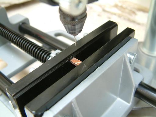

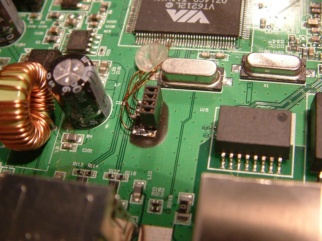

Hello again!

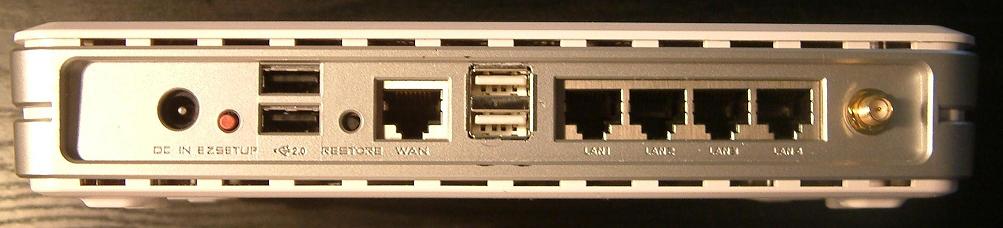

Following the post "Additional USB ports and Internal HD!" by parper, I decided to add two more USB ports by soldering tiny wires on the pins of the VIA (VT6212L) chip. I used very thin veneer-insulated copper wire taken from the coil windings of a Cathode Ray Tube (CRT) of an old monitor. I had a bit of a trouble finding the correct circuit schematic and component values on the forum or the net (I failed to actually), so I examined the wiring of the existing USB ports and used a multimeter to figure these out. The findings are: Each one of the data pins (usb3D+,usb3D-,usb4D+,usb4D-) is tied to ground by an 15K ohm resistor and filtered in pairs using magnetically coupled inductors. Power supply and grounding are also filtered by inductors and capacitors. The configuration I finally went with is: four 15K ohm resistors tying the usb data pins to ground, and some simple LC (inductor capacitor) filter for the positive power supply. Having trouble to locate suitable smd resistors in the "junk pile", pairs of 10K ohm and 4k7 ohm resistors off an old ink-jet printer board were used in series. The 100nf ceramic disc capacitors and ferrite beads for the supply filter were kindly provided by the same old monitor as before.
A standard dual stacked type A female pcb connector was "slightly" modified and the end result is quite acceptable. The case is also modified, with a rectangular hole between the WAN and LAN1 connectors, to house the usb connector.
In details, the usb connector was fitted with an eight pin standard 2.54 cm pitch gold plated male connector, while the rest of the circuit (pull-ups and filters) was attached to it’s respective female connector. The usb connector is not attached to the wl500gp PCB, and it’s only held in place by the metallic springs on the top and bottom of it’s body, holding against the rectangular opening on the case.
I have later refined the USB mod. This was needed since I already had managed to remove most of the fine wires while accidentally pulling the resistor – filters pcb. Oyabun is right: the previous implementation of mine was a little mess!Electrical connections are now achieved using a very small piece of pcb, with a fine pitch 1mm, gold contact, female connector, attached to the asus mainboard with Devcon - high strength "plastic steel epoxy". I have to admit it looks really neater! This way things are a bit more modular too, which comes handy since I plan to design and etch a small pcb to house the pull-ups and the filters, all hopefully in smd sizes. When successful, all results schematics, pcb layouts and relative photos will be posted here
Happy modding!

Bellow are some pictures, one during the fabrication of the small pcb (included for it's strange beauty and it's mild industrial after-taste), and two more of it as it looks on the board. The little wires were not soldered on it yet; since it took 24 hours waiting for the epoxy to fully cure. The last picture shows the final arrangment with the little (fragile) wires in place.

Asus WL-500b (BCM5325M) - EEPROM AT93C46 (U9 8pin)
http://wl500g.info/showthread.php?t=5593
Asus_WL-500_Gold_Premium_rev1.14
Hardware

@all:
It seems that we need indeed registers info to proceed this way. Reverse engineering the drivers or firmware that mitek mentions (if any) in hope that they
actually use the eeprom interface of these chips might provide a solution... I haven't spoted anything yet but haven't really looked for it that hard either.
We would first need to spot some hardware which implements the eeprom connection with either VT6212L or BCM5325. A "Programmer's Guide" or at least
some datasheets for the BCM4704 would be our heaven, but no such thing in sight anywhere...Does Broadcom only provides these info's under NDA's?
Or even worst, to business partners only, under NDA's too? Do they actually make you swear to eatthe hardcopy of the documents if you let any one
else even have a glimpse on them? Seriously now, has anyone tried to approach them directly?
Inertial

Hello again!
Let me present some info on the mini-PCI bus and the mini-PCI cards Type III, as the ones found on routers.
The connector has 124 pins. A list of pins and signal names, adapted from PCI Local Bus Specifications Rev 2.3 and pinouts.ru follows:
Code:Mini PCI Card Type III System Connector Pinout Pin Signal Pin Signal Pin Signal Pin Signal 1 TIP 2 RING 63 3.3V 64 FRAME# Key Key 65 CLKRUN# 66 TRDY# 3 8PMJ-3 4 8PMJ-1 67 SERR# 68 STOP# 5 8PMJ-6 6 8PMJ-2 69 GROUND 70 3.3V 7 8PMJ-7 8 8PMJ-4 71 PERR# 72 DEVSEL# 9 8PMJ-8 10 8PMJ-5 73 C/BE[1]# 74 GROUND 11 LED1_GRNP 12 LED2_YELP 75 AD[14] 76 AD[15] 13 LED1_GRNN 14 LED2_YELN 77 GROUND 78 AD[13] 15 CHSGND 16 RESERVED 79 AD[12] 80 AD[11] 17 INTB# 18 5V 81 AD[10] 82 GROUND 19 3.3V 20 INTA# 83 GROUND 84 AD[09] 21 RESERVED 22 RESERVED 85 AD[08] 86 C/BE[0]# 23 GROUND 24 3.3VAUX 87 AD[07] 88 3.3V 25 CLK 26 RST# 89 3.3V 90 AD[06] 27 GROUND 28 3.3V 91 AD[05] 92 AD[04] 29 REQ# 30 GNT# 93 RESERVED 94 AD[02] 31 3.3V 32 GROUND 95 AD[03] 96 AD[00] 33 AD[31] 34 PME# 97 5V 98 RESERVED_WIP 35 AD[29] 36 RESERVED 99 AD[01] 100 RESERVED_WIP 37 GROUND 38 AD[30] 101 GROUND 102 GROUND 39 AD[27] 40 3.3V 103 AC_SYNC 104 M66EN 41 AD[25] 42 AD[28] 105 AC_SDATA_IN 106 AC_SDATA_OUT 43 RESERVED 44 AD[26] 107 AC_BIT_CLK 108 AC_CODEC_ID0# 45 C/BE[3]# 46 AD[24] 109 AC_CODEC_ID1# 110 AC_RESET# 47 AD[23] 48 IDSEL 111 MOD_AUDIO_MON 112 RESERVED 49 GROUND 50 GROUND 113 AUDIO_GND 114 GROUND 51 AD[21] 52 AD[22] 115 SYS_AUDIO_OUT 116 SYS_AUDIO_IN 53 AD[19] 54 AD[20] 117 SYS_AUDIO_OUT GND 118 SYS_AUDIO_IN GND 55 GROUND 56 PAR 119 AUDIO_GND 120 AUDIO_GND 57 AD[17] 58 AD[18] 121 RESERVED 122 MPCIACT# 59 C/BE[2]# 60 AD[16] 123 VCC5VA 124 3.3VAUX 61 IRDY# 62 GROUND 8PMJ = 8 position modular jack connector pin (RJ45)
To help things some more, an image of the actual wi-fi card used in the wl500gP, overlayed with pin numbers and signal names is attached bellow.
Some mechanical specs for type III connectors (adapted from the PCI Local Bus Specifications Rev 2.3) where found and are attached bellow too.
While having a look at the mainboards of wl700gE and wl500W, I noticed two interresting things:
The wl500W seems to have pads for a 68 pins pcb connector(!) on the underside of the mainboard (Bottom Layer). From a quick look i had, it seems that most of the interesting signals of the mini-PCI bus are present there. Initially i hopped they where EBI signals (Expansion Bus Interface) but no luck...
Wl700gE seems to have pads for a type III mini-PCI connector!
I am currently fighting my way through the PCI Local Bus Specs. Maybe an easier way (?) to approach things would be a PCI-to-PCI Bridge on a mini-PCI card (if such thing exists). This could be used in order to connect a multitude of Mini-PCI cards. I still dont understand all about how PCI's work, and reserve the right to return on the subject after completing my reading...
Inertial
I managed to find a detailed enough picture of the underside of wl700gE mainboard, here in the forum.
82 connected pads out of the 124 on the wl700gE mainboard as opposed to 86 connected pads on the wl120v2, but still it yields a match!
These are indeed pads for a mini-PCI type III connector
Actually, four Reserved pins are left Non Connected at wl700gE as opposed to the WL120V2 wifi card.
Things must be a bit crowded at the PCI bus of wl700gE, between IDE controllers, USB 2.0 Hosts and onboard wifi's. Maybe the IDE controller is on the EBI bus, I will get hold of a wl700gE for a while, that will give me the chance to have a closer look... The wl700gE will be on short loan though, no chances for hardware experimentations...Whether it's possible to connect a mini-PCI connector and a type III card and make it visible for the firmware, i know not. I had a quick read through the firmware's source code of pci.c and such, i can't really say...
I could probably use some help on that one.
Here goes the picture overlayed with pin numbers and signal names.
Inertial

Well these wonderful pads of what seems to be an 8-pin ic, where there, next to the flash chip, on all wl500gP's, wl500w's and wl700gE's, waiting to be noticed...
What that IC might have been remains unclear...
If it was a real time clock, wouldn't it need a back-up battery? most probably yes.
An eeprom then...? but what it's use would be...?
Or do they give access to some internal pins of nearby chips...? Probably not since test points or connector awaiting pads would have been used in that case...
It seems (a wild guess) that there might be the signals of an I2C or an SPI presented there...
Having zero spare time now, it will take a while before I could have a chance to investigate this matter further...
The pads are know to belong to an IC nicknamed U12
If you can shed light on this case... we want to hear from you
Inertial
Bellow is a picture of the UUP's (Unidentified Unsoldered Pads) in question...
