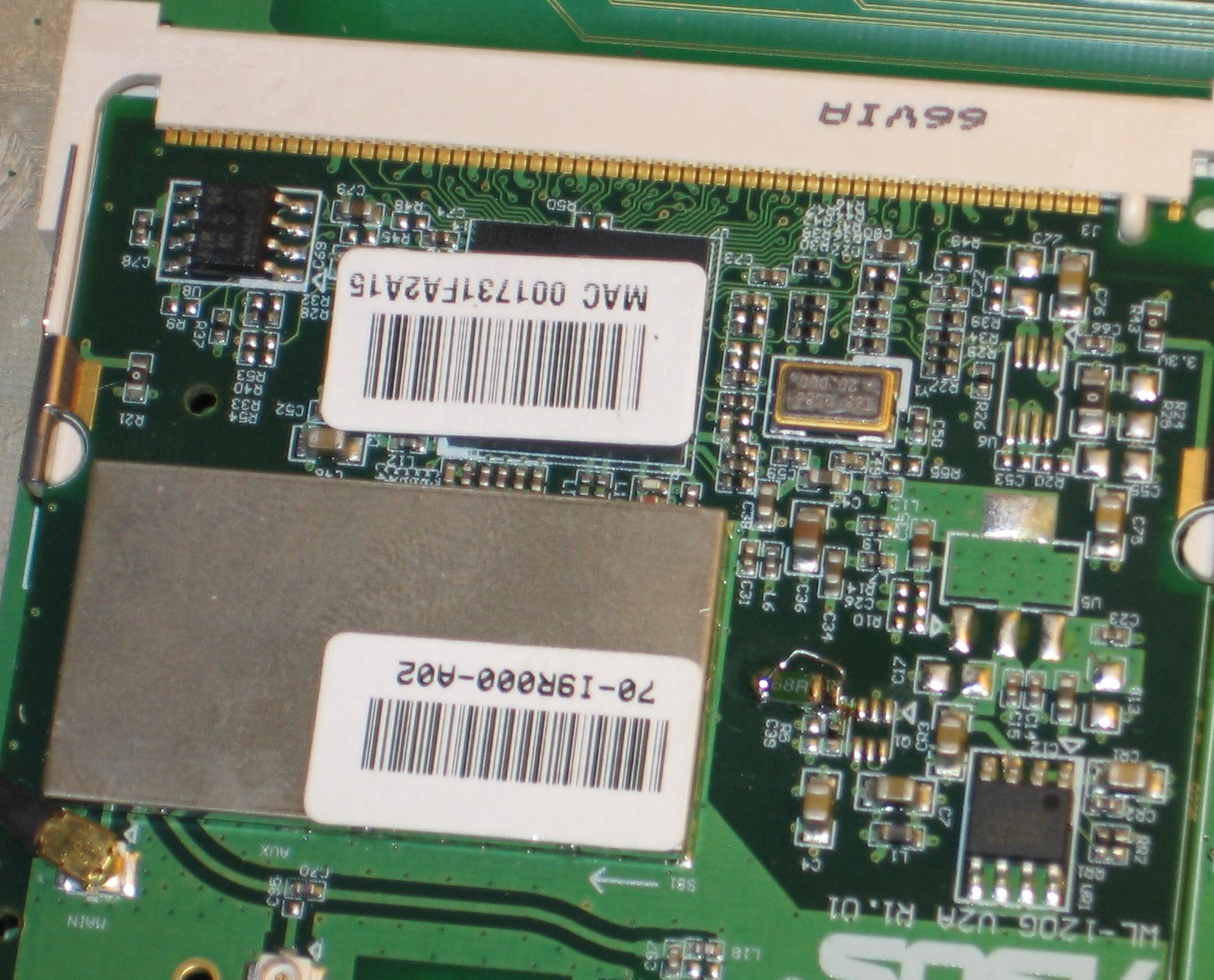

    Hi there,
    I just finished the R17 mod for my WL500gP.
    Noise level went down from -98 to -84
    I simply soldered a 68 ohm SMD resistor parallel to R17:
    Solder one side of the new resistor to the side of R17 that is closest to the shielding. Then solder a thin wire between the other sides of the two resistors.
    See the attached image.
    Pim.
    By the way, the reason I used a 68 ohm resistor was because the local component store didn't have a 62 ohm.
    I could choose between 56 and 68 ohm. The latter seemed safer.
    Later, when I choose not to remove R17 (the led-free solder didn't melt with my low power soldering iron) I realized that 68 ohm is perfect.
    A 62K ohm and a 68 ohm resistor in parallel together give (almost exactly) 62 ohm.

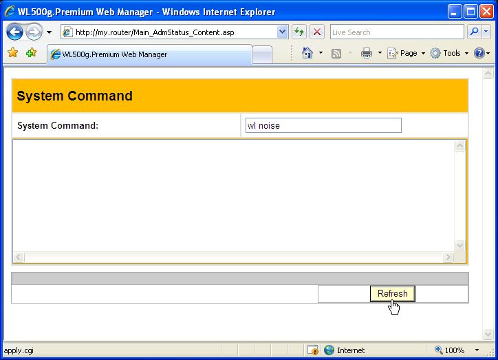

    Quote Originally Posted by Oleg View Post
    Oh... Yes. We've checked number of units and it appears, that all units manufactured since August 2007 seems to have correct resistor installed. You could check your unit manufacture date by examining first 2 digits in the unit serial number: i.e. 78 stays for August 2007, 79 for September, ... 7c for December.
    The easiest way to check if you've right resistor installed is to type
    wl noise
    in the "hidden" page. This will return measured noise value from radio.
    62 Ohm resistor gives -89 dB and above.
    If you've something between -99..-92 then pre-amplifier is not working (62 kOhm resistor installed).
    Where is the "hidden" page?
    how can I give the noise measure?
    Thanks in advantage

    Quote Originally Posted by Garluk View Post
    I have oleg's firmware.
    If I go to the Main_AdmStatus_Content.asp page I get system command form.
    Can you help me?
    Tanks
    click on this link -> http://my.router/Main_AdmStatus_Content.asp
    it will apear a secret page from your router's config webpage called System Command
    in this window you will have to type the following command -> wl noise and click Refresh it will give you a negative value
    if your result is something between -99 and -92 you have 62 K Ohm resistor installed
    if your result is -89 or a higher value (eg -86) then you have the right resistor installed (62Ohm)
    thanks..
    I give -90 value.
    I think have a right resistor installed but the measured noise value is not good. pre-amplifier not working correctly.
