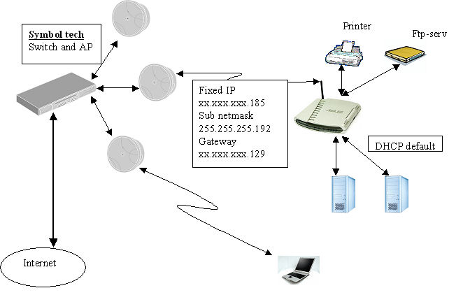

    OK Lets try
    This is my wanted setup.
    So, how should this be accomplished ?
    Basically, you just exchange WAN with WIRELESS. But I believe there is a few things that you need to change :
    bridge
    The default configure bridge WIRELESS and LAN. You may need to break this or all your LAN port may be opened to the world, though I read somewhere that wireless bridge this way may not work at all.
    firewall/SNAT
    You would need to change the firewall rules so it blocks things from WIRELESS instead from WAN and SNAT on outgoing through WIRELESS instead of WAN.
    put WIRELESS in client mode
    So your WIRELESS interface act the same as the "notebook" in the diagram.
    That should be it. Don't ask me how though as I am using openwrt and not the ASUS firmware but they should be pretty similiar in terms of setup.
    Sep 2004
    22
    Your thoughts are about the same as mine when I started.
    Now I don't know
    Bridge: I set "WDS only" in bridge settings. Open ports?
    Well, when making a port scanning the only port reply I get is from 21-ftp, 80-www, 515-printer and sometimes 5431-ParkAgent (?) and that is from both LAN-side and WAN/wireless side. Different firewall or NAT-setting don't change that.
    Wireless in Client mode:
    Well, that option is not on the standard meny. That is also what ASUS Tech support Center answered "WL-500g can not be a wireless client".
    And I've tested Olegs 1.7.5.9 and setting: nvram set 13_x_ClientMode=2 ....
    No luck. Sure it's working ?
    Looking into this forum, openwrt seems to demand some deeper knowledge in programming or codes. I don't have that.
