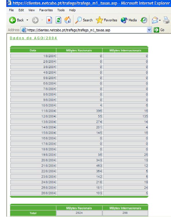

    What im saying is that, probably coolzero checked his logs and there was traffic activity, in my logs there is no activity.
    You can see the days without traffic. The rest of the days is eMule
    Regards.
