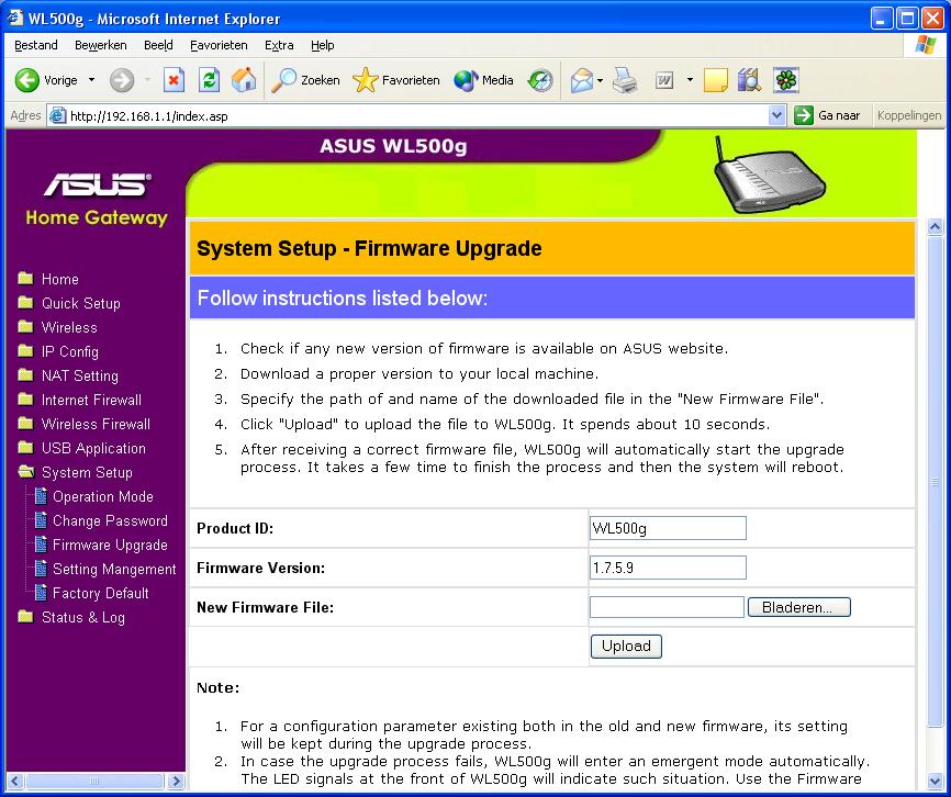

okay.. upgrading to 1.7.5.9
waiting for the device to come up again..
stay tuned
okay found some strange things.. it seems asus is busy integrating Samba
and it looks like they are struggling with the NAS thing for WPA encryption (e.g. this does not work when WDS is enabled for some reason)
