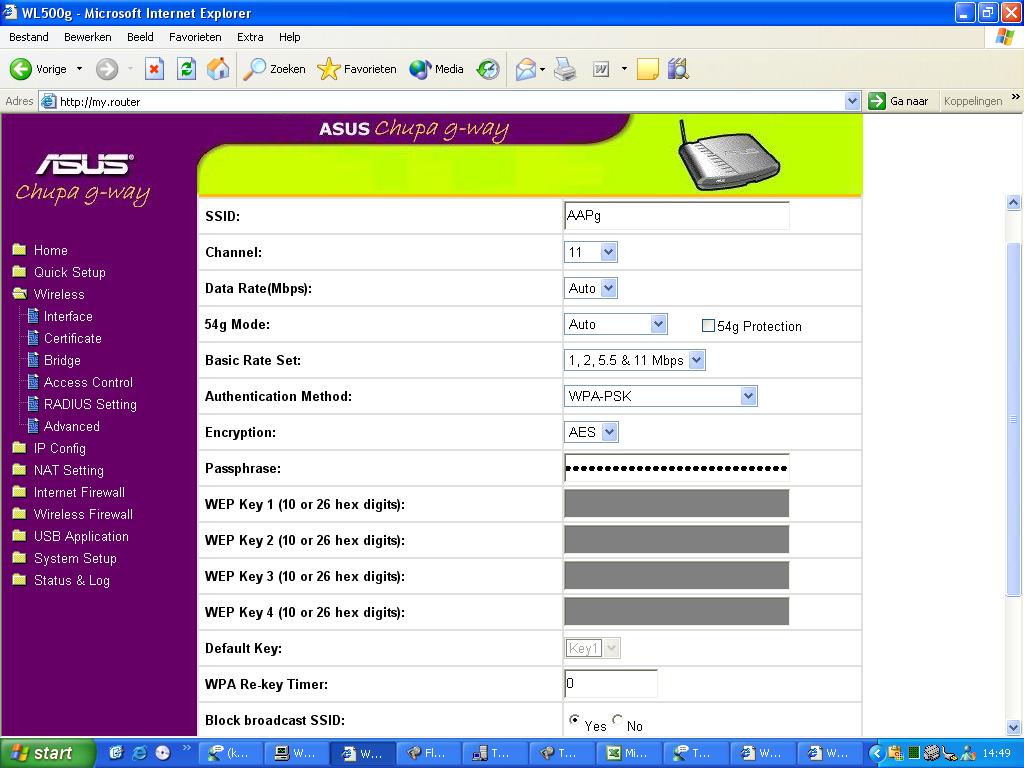

    did you do a hard reset already for the wl500g ? it could be messed up by some other user (who had that wl500g before you did...)
    here it always worked perfectly (with AES) see also attached file for working setup (for me)
    and use as passphrase '9F062FF8D6CA11039801585A09' for example.

    heheh yes.. AAPg came from my WL300 which was named AAP because of Asus Access Point.
    but in this way it should work.
