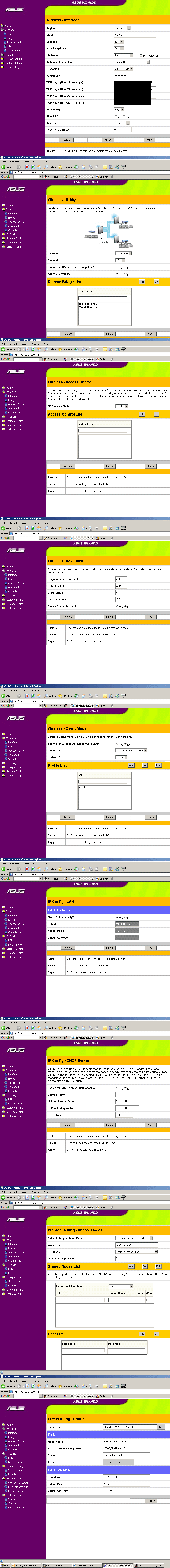

I just installed my brand new WL-HDD. MY setup is a router (with DHCP server and DSL modem inside, 2 copmputers connected to the router). I want to use the WL-HDD via WLAN connection to the router with the 2 other computers.
The WL-HDD is set up so far, when i connect it to the router by LAN everything works fine. With WLAN I can't get any connection. Key, mode and the rest is set up, but I cant get it to work. Firmware is 1.1.2.8.
Any ideas ????

That didn't help.
Setup:
- WLAN/DSL-Router connected to internet
- 2 computers connected to this router via LAN
WL-HDD:
- should be connected to router via WLAN
- should be accessible by both computers
What's wrong ??

also didn't help...
restore stuff to default
can you connect to SSID WL-HDD then? (meaning without any encryption set at your client)
if yes then there is a problem in your configuration somewhere
change stuff step by step then you will find the error
