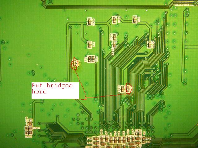

    If you do upgrade, practice on something cheaper first until you feel you can do the soldering without damage to the router.. like an old motherboard, find a suitable chip, remove it and put it back... hopefully it will work as before (but do check that it worked in the first place )

    However, you have buy and mount MT48LC16M16A2P-75: D from micron, confirm?

    MT48LC16M16A2P-75
    Yes, that is what I have. Don't forget about the two jumpers also.. they are on the other side of the board.
    I will try to post pictures by thursday.
    Edit The P/TG is only for Rohs so unless you are worried about that it does'nt matter.

    As promised, pictures!
    Merry Christmas, everyone!

    Fine work :-)
    You could try to clean off the residue of the soldering with alcohol.
    Merry christmas from me too!
    Thanks,
    Its a no-clean flux and quite hard to get rid off! I did the soldering twice since I was a bit sloppy the first time, in the end it turned out to be one of the bridges, so I used a bit more flux then necessary. Not my finest work I can tell you
    I am a bit tempted to try and fit 128MB, now that I have a source for the chips.. still a bit pricey though.
