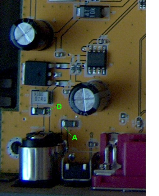

    Quote Originally Posted by wtzm
    I _guess_ that the second port can be used, but I'm not quite sure if the method works. (Haven't had time to try it.)
    On my rev. 2.4 wl-500g there is a 15k resistor package (RN28) which seems to provide the necessary pull down to GND for the two USB Ports (each one has two differential signals - USB_N and USB_P, of course). Maybe it's enough to connect an USB socket to the two solder points (and +5V & GND of course).
    Attachment 605
    Note: USB1 means USB - Port1 and USB2 means USB - Port 2.
    wtzm, could you please correct the image a bit?
    I believe that USB2 pins should be interchanged ==>
    		   -----    ____
    	USB1_N	--I     I--|GND \_
    	USB1_P	--I     I--|   ---
    	USB2_P	--I     I--|  /
    	USB2_N	--I     I--|_/
                       RN28
    In addition two 15 ohm serial resistors should be used. Then you can enjoy using the second USB port...

    Well, it just works.
    I relied on the series resistance of bad solder joints, so the 15 Ohm Resistors weren't necessary *g*. (BTW: I assume these are just there as a safeguard measure in case somebody connects a defective device)

    I used the opportunity to measure the total current consumption in this configuration (speedtouch usb + bus powered hub + cardreader; wireless disabled): ~1.3A.
    The maximum current consumption during startup, without any USB devices, all ethernet ports disconnected: 780mA and 715mA after startup (idle). The same configuration with one of the LAN ports connected: 835mA and 770mA.
    The only thing missing at the moment is a way to (physically) mount another USB connector at the case; Maybe on the front, just above (left) of the PWR Led?

    [Technik], please confirm that this is the correct shematic:
                    ___    ____
                 o-|N1 |--|GND \_
    USB2      R1 o-|P1 |--|    __
    pin3  --/\/\/--|P2 |--|   /
    pin2  --/\/\/--|N2 |--|__/
              R2    ---
                   RN28
    pin 1 -- +5v
    pin 4 -- gnd)
    (R1=R2=15ohm)
    (usb pinout: http://www.interfacebus.com/Design_Connector_USB.html#b )
    Also, did you use external 15ohm resistors, or did you "reuse" the free RN2 15 Ohm resistances on the board?
    where did you get the +5v from? (which part of the pcb?)
    I guess a capacitor next to the +5v input of pin1 would be a nice addon, don't you think?
    regards,
    [ WL-500G | fw: 1.9.2.7-7f ]

    You can get power from the pins labeled CE2 (this capacitor is at least on my pcb not populated) next to the onboard USB connector.

    Quote Originally Posted by gwl
    nice post Technik!
    I've been so busy that I haven't has the time to check this out...
    I remembered to check the forum today, and was glad to find that someone has a solution.
                    ___    ____
                 o-|N1 |--|GND \_
              R2    ---
                   RN28
    pin 1 -- +5v
    pin 4 -- gnd)
    (R1=R2=15ohm)
    regards,
    Thanks!
    I can confirm that your schematic diagram is OK.
    As soldering on small onboard SMD parts is a bit difficult, I prefer using external resistors.
    I am getting 5V from the input connector as marked, not directly but through additional reversible 0.7A fuse (PolySwitch).
    In case you need a high power for external HDD, I would use some additional serial coils on both 5V and GND (taken from the power input connector) and ~1.2A fuse.

    Please don't try to do it if the info above is not sufficient for you. Onboard parts that you need to solder on are quite small and without some experiences you may permanently damage the router. Also warranty is void as soon as you remove the warranty label covering one screw...
    Quote Originally Posted by Technik
    Thanks for the advice.
    In fact I don't understand the info posted here maybe if it was in portuguese ... Now the solder and warranty are not a problem as I have a friend with solder experience and warranty was gone long time ago.
    Miguel
    Czech Republic
    270
    OK then... So this is a (perhaps) more clear "how to".
    Router board version needs to be 2.xx as older boards have a different layout.
    Good luck!
    Good luck!
    Thanks for the answer. Yes this is a more clear "how to" .
    Just one last question. In the resistors you mention 15 Ohm, the fuse of 1 amp but what about the coil (ferrite slug) resistance ?
    Thanks,
    Miguel
    Czech Republic
    270
    Quote Originally Posted by roque69
    Thanks,
    Miguel
    You can use almost any coil type, it's not a critical part - the reason is to eliminate interference. D.C. resistance of the coil should be max. 0.1 Ohm.
