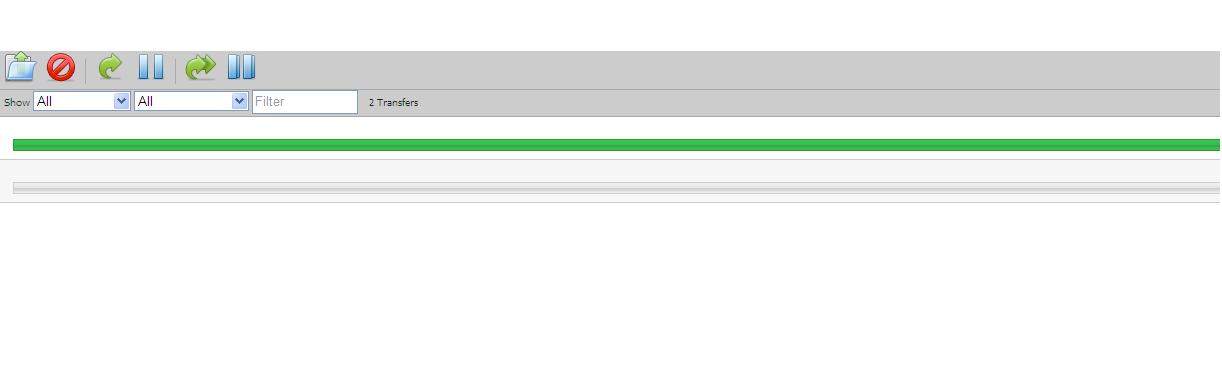

    I accidentally updated and upgraded ipkg, my transmission has upgraded to 2.61-1 and now web interface is not working very well
    Hi, i had same problem with corrupted web interface...
    ...for me helped fix whitch I found somewhere in german discussion on this forum (I don't understand german, but I tried it and it is working )
    ipkg remove transmission
    ipkg install http://demongloom.dyndns.info:81/asus/transmission_2.50-1_mipsel.ipk
    [root@router init.d]$ ipkg remove transmission
    Removing package transmission from /opt/...
    Successfully terminated.
    [root@router init.d]$ ipkg install http://demongloom.dyndns.info:81/asus/transmission_2.50-1_mipsel.ipk
    Downloading http://demongloom.dyndns.info:81/asus/transmission_2.50-1_mipsel.ipk
    Installing transmission (2.61-1) to /opt/...
    Downloading http://ipkg.nslu2-linux.org/feeds/optware/oleg/cross/stable/transmission_2.61-1_mipsel.ipk
    Configuring transmission

    Got it to work thanks
