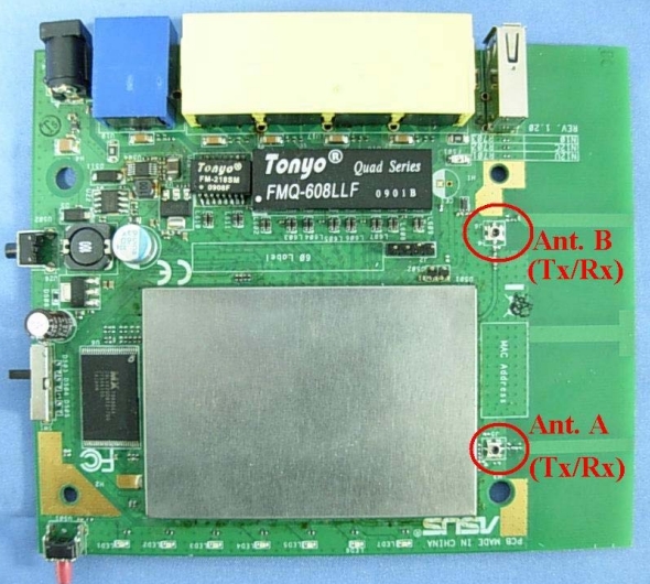

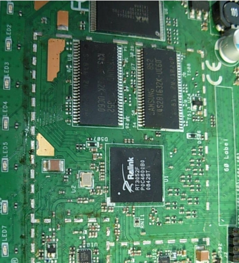

    ASUS RT-N13U with 3.5G support
    ASUS RT-N13U
    CPU: RaLink RT3052F 384Mhz (MIPS 24K)
    RAM: 32Mb (2 x 16Mb) SDR 16bit
    ROM: 4Mb Flash USB: 1 x 2.0 (SoC)
    WLAN: Dual Radio 802.11n (SoC)
    OS: Linux version 2.6.21
    http://code.google.com/p/wl500g/wiki/Devices
    RTN-13U : http://www.xard.ru/post/17114/default.asp
    Trade Name - ASUS Model No. - RT-N13U
    Product Name - Wireless N Router with All-in-One Printer Server
    Product Type - WLAN (2TX,2RX) Channel Control - Manual
    Antenna Type Printed  ANT A (TX/RX): 2.77dBi; ANT B (TX/RX): 3.85 dBi
    Frequency Range - IEEE 802.11b/g & IEEE 802.11n (20MHz) 2412~2462MHz
    Frequency Range - IEEE 802.11n (40MHz) 2422~2452MHz
    Type of Modulation (IEEE 802.11b) Direct Sequence Spread Spectrum(DSSS)
    Type of Modulation (IEEE 802.11g) Orthogonal Frequency Division Multiplex(OFDM)
    Data Speed (IEEE 802.11b) 1Mbps, 2Mbps, 5.5Mbps, 11Mbps
    Data Speed (IEEE 802.11g) 6Mbps,9Mbps,12Mbps,18Mbps,24Mbps,36Mbps,48Mbps,54Mbps
    Data Speed (IEEE 802.11n) Support a subset of the combination of GI, MCS 0~15
    and bandwidth defined in 802.11n
    Power Adapter ADS0129-W I: 100-240V 50/60Hz 0.5A O: 12V, 1.0A
    ASUS RT-N13U with 3.5G support:
    Add 3.5G USB dongle support on ASUS RT-N13U
    The RT-N13U UI is good enough, so I don't change much.
    Only add 3.5G setting in advance setting --> USB Application
    This FW supports HUAWEI E169, E220, Bandluxe C270, OPTION 225 now.
