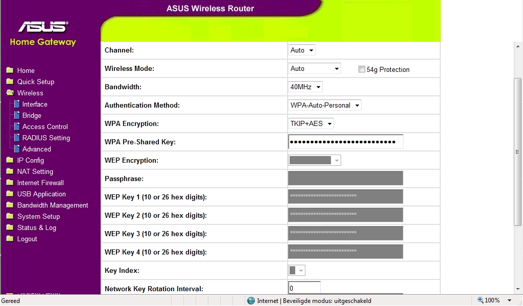

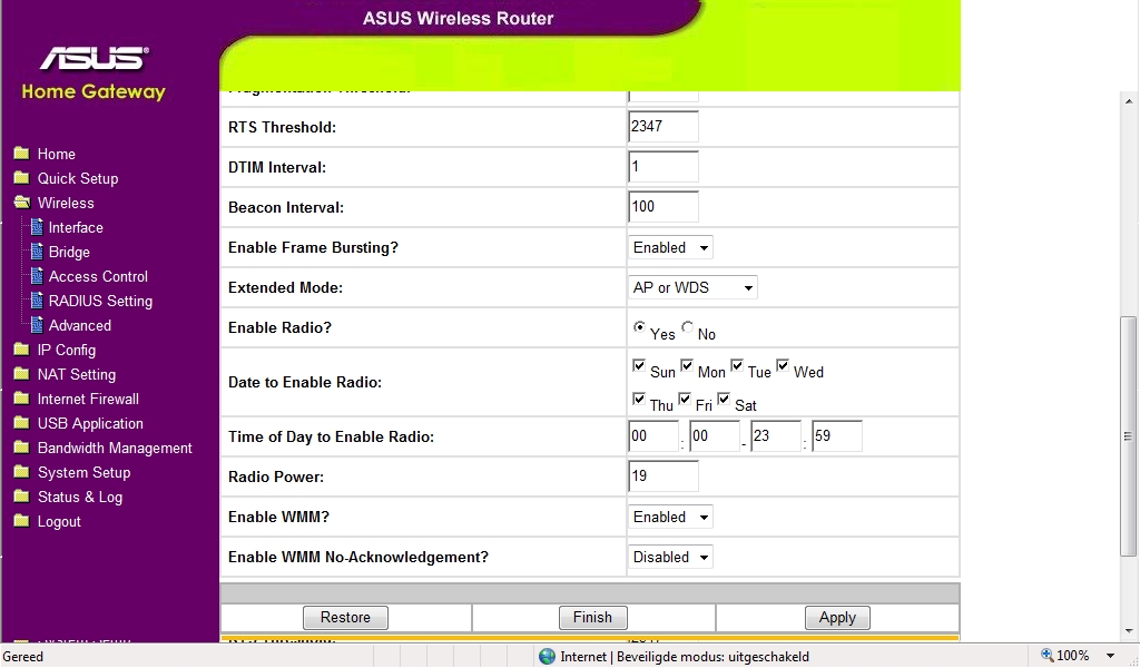

    I get a 130 with oleg...
    I made some screens of my settings:
    first is the normal configuration
    last 2 are from the advanced tab
    maybe some other random advice to get the maximum out of your router...

    Thank you! You do kick ass!
    It's all working now. Can't wait to set all the other goodies that are available (nas, ftp, torrents, etc.)!

    haha, thank you, but I just had to choose a hostname ey
    I think the most importand thing is the other regulatory mode set to H instead of D
    the H version is newer and used in the intel drivers
