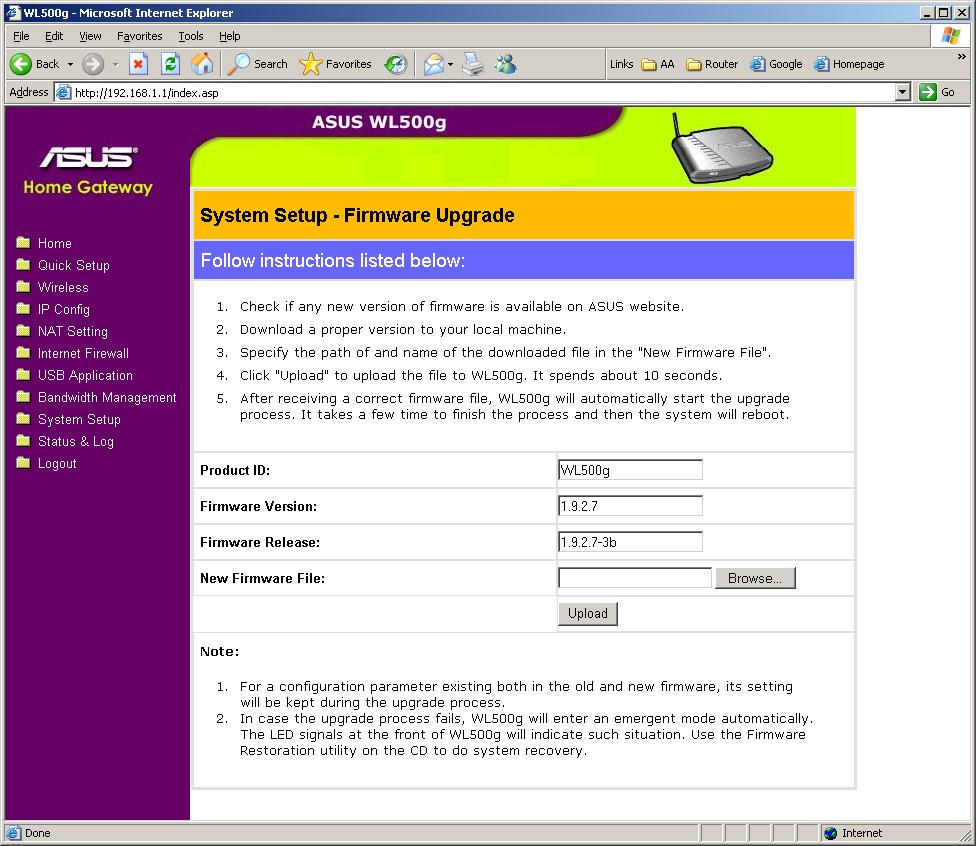

    - Use the webinterface to upload the correct firmware as shown in this image. Double check if you're uploading the correct firmware before uploading!
    - Wait for the upgrade process to finish. If it takes more then 10 minutes to finish then refresh the webinterface (Press F5 in IE).

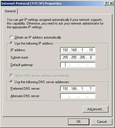

    - Configure Windows TCP/IP networking to have static IP address 192.168.1.10 as shown in this image.
